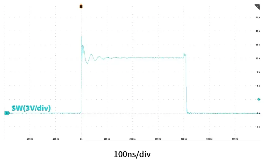

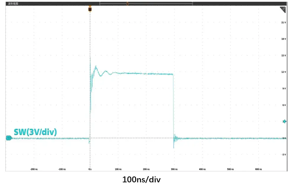

BPD80690 Switching Waveform
VIN= 12V, IOUT = 90A

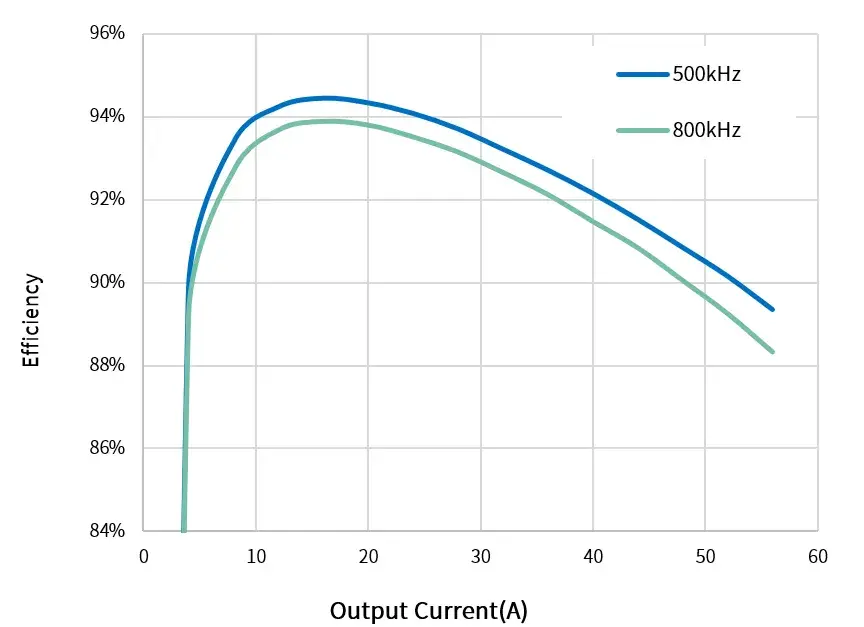

BPD80690 Efficiency
VOUT= 1.8V, L = 150nH

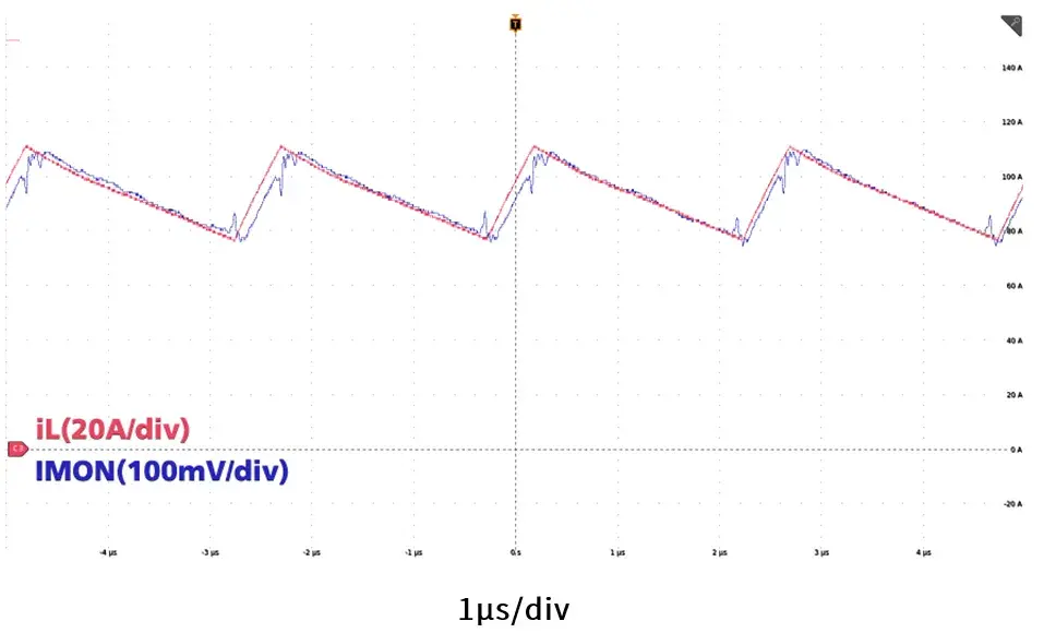

BPD80690 IMON Waveform

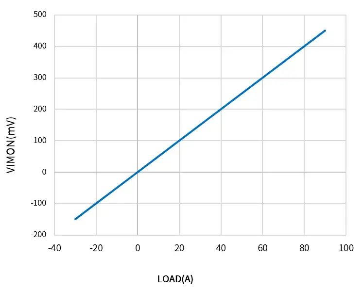

BPD80690 IMON Accuracy
VIN= 12V, VCC=VDRV=5V

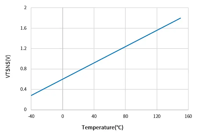

BPD80690 TMON Accuracy
